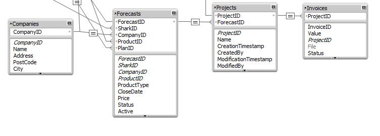

Faria Posted June 25, 2018 Posted June 25, 2018 Hello, Im in need of some assistance. Im fairly new to Filemaker and Im trying to do show some information that It aint showing. Basically I have: A form for the invoices and I want to show the company name on it. Already filled in within the forecast table, but I cant seem to get that value in the projects form and in the invoice forms. Every time I try to get a value from 2 tables away it doesnt work. Am I missing something? Regards, Quote

Faria Posted June 25, 2018 Author Posted June 25, 2018 (edited) In the Forecast I cant get the Companies Name. In Projects I can get the Forecast associated to it. But I cant get the company Name with the Invoice associated with the project. To specify I want an already filled field that was designated in Forecasts. Edited June 25, 2018 by Faria Quote
Banach Posted June 25, 2018 Posted June 25, 2018 So then it seems that the relationship between projects and invoices is not fulfilled. Does projectID in Invoices contain the correct Project id, can you get the project name into the invoice? Quote
Faria Posted June 27, 2018 Author Posted June 27, 2018 Yes. I can get the project name. and Within the project layout I can get the company name. But in Invoices I cannot get the company. Quote
Banach Posted June 27, 2018 Posted June 27, 2018 Are the ProjectID fieldtypes in projects and invoices the same and compatible with the contents? Quote

Faria Posted July 5, 2018 Author Posted July 5, 2018 Hello, I managed to find the problem. It was due to a relation. Because you cant have 2 tables related to one, weird enough, So I made a workaround in terms of connections and made it work. Thank you Quote
hbrendel Posted July 5, 2018 Posted July 5, 2018 (edited) 1 uur geleden zei Faria: It was due to a relation. Because you cant have 2 tables related to one, weird enough, So I made a workaround in terms of connections and made it work. Please elaborate. I don't understand anything of this statement. In my perception you can have as many tables related to one as you ever would like. And what is "a workaround in terms of connections"? Edited July 5, 2018 by hbrendel Quote
Faria Posted July 5, 2018 Author Posted July 5, 2018 Ok. In the previous tables I shown, you can see in th eForecast Table the SharkID, it corresponds to a Shark table. So, you have that connection, one Shark is in charge of a Forecast. Then, There is a parallel table Timesheet, connected to the table Projects, whre you can say, a Shark recorded X hours in a project Y. Not the same shark set up previously. So in the Timesheet table, you also have a SharkID, And THAT connection is not possible in Filemaker. In a normal DB system it is possible, not here though, therefore I just removed that connection, and it started to work again. I kinda not know why though. Filemaker isnt making much sense to be honest. Quote
