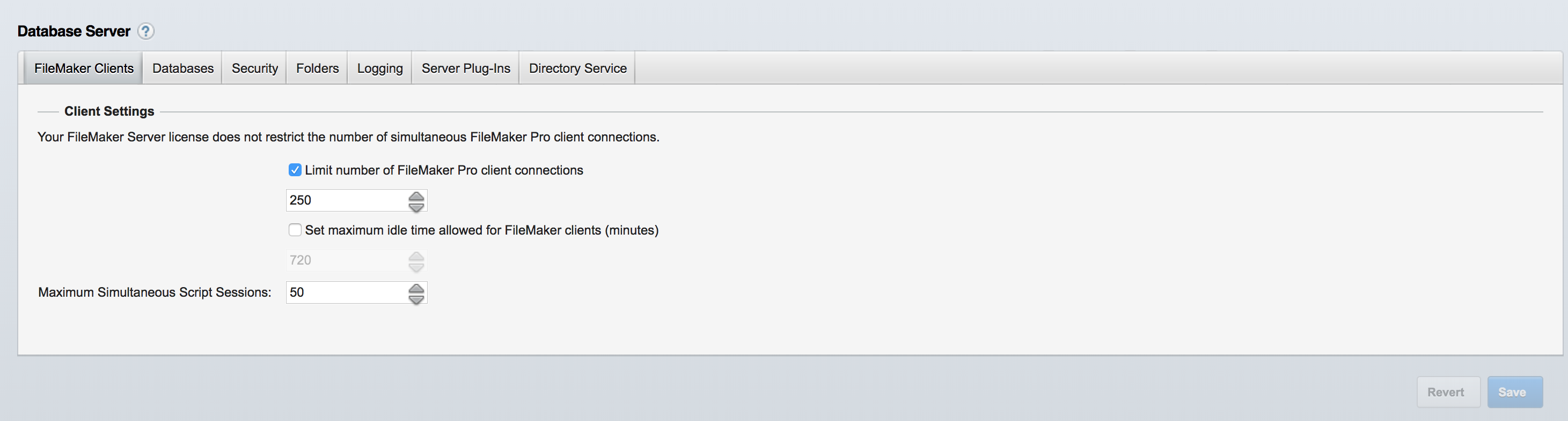

0 andries Posted August 7, 2018 Posted August 7, 2018 Admin Console -> Database Server -> Set Maximum Idle time Quote
