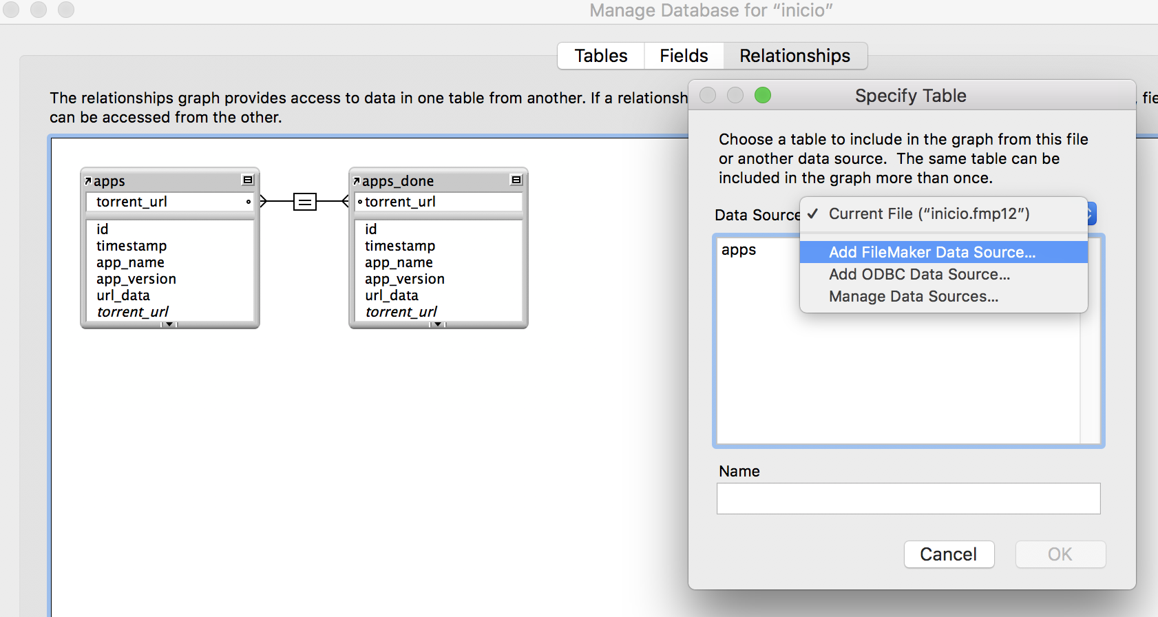

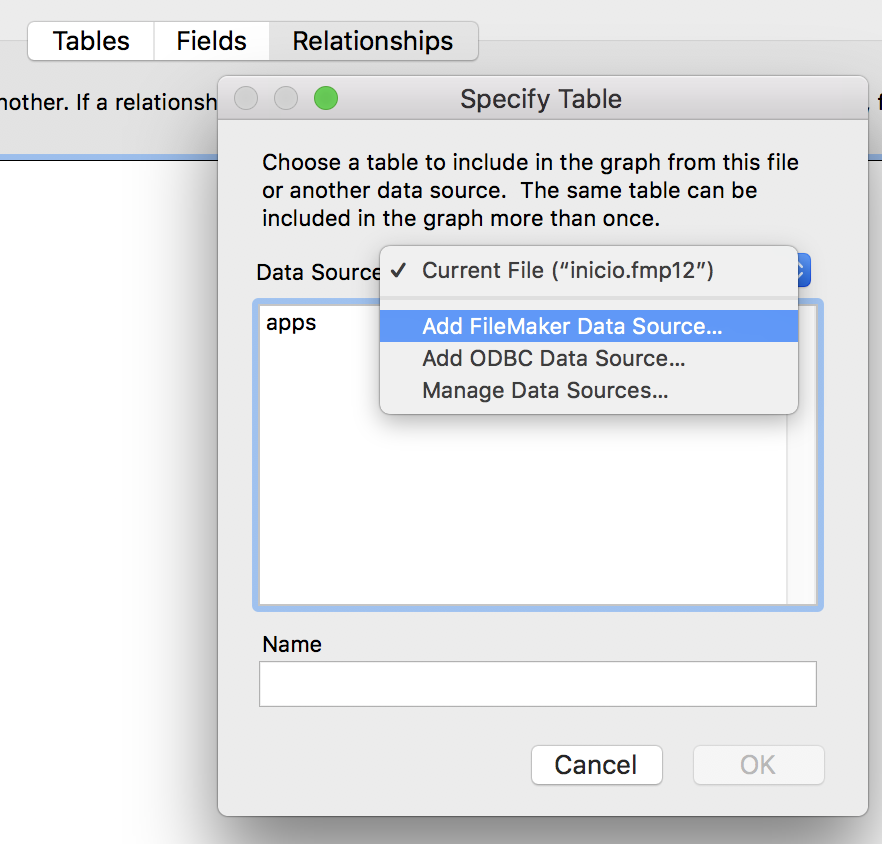

0 Banach Posted February 2, 2020 Posted February 2, 2020 (edited) Kies in je relatiegrafiek het andere FM bestand als datasource: Edited February 2, 2020 by Banach Quote
